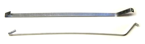

I've searched the forum for related threads and there doesn't seem to be a consensus on whether the gas tank straps on a 1970 GTO are painted black or are unfinished.
I picked up this set from the Parts Place and they appear to be unfinished. Should I paint them black (got a can of Rustoleum semi-gloss black laying around)?
FWIW...Arlington TX car.

The consensus is that the straps were on the car when the underside was painted black. Therefor the straps were black. Original unrestored cars do have black paint on them but since there were not prepped the paint overtime flakes off. If you are restoring the car for judging, I would paint them black.

Since mine are galvanized (according to the Parts Place) and I don't want paint to flake off like factory, I'm thinking it might make sense to spray the straps with a water-based primer before hitting with the semi-gloss black.
Rustoleum recommends this for proper adhesion...
