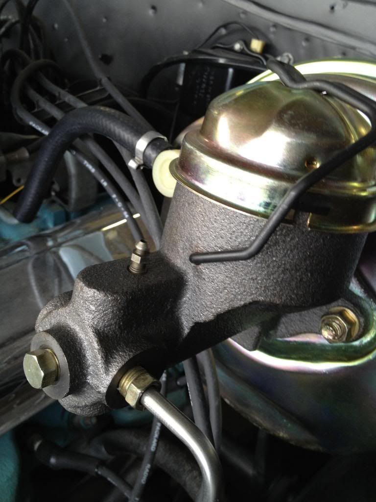

Thanks, guys. Look at this photo of my MC. Notice the bleed screw. What is its purpose?
